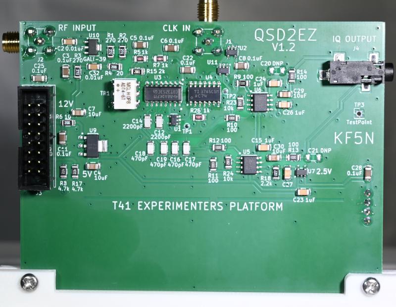

Build Tips
In general, QSD2EZ is easier to build than the original V010/V011 series boards. There are a few items to be aware of to avoid build errors.
The most probable error(s) are incorrect orientation of the flip-flop, multiplexer, transformer, and instrumentation amplifier devices. The pin 1 markings on the devices are very difficult to see. The transformer markings are easy to read; this should be clear in the photograph of the finished board.
Here are details on each part with regards to proper orientation of the board. The descriptions are viewing the top side of the board, with the “T41 EXPERIMENTERS PLATFORM” near the bottom of the board in normal left-to-right reading orientation.
Transformer TR1
The transformer TR1 should be placed with the “dot” towards the 16 pin connector. If you are unsure, refer to the photo below.
Dual Flip-Flop U4
Pin 1 should be in the lower left corner. This is marked with a small white triangle on the PCB.
3253 Multiplexer U3
Pin 1 is at the upper right. This is marked with a small white dot on the PCB.
Instrumentation Amplifiers AD8226 U5 and U6
Pin 1 indicated with a dot on the PCB. However, both parts are oriented the same, with Pin 1 towards the upper left. There is also a bevel on the package on the left side (same side as pin 1).
Non-placed Parts
C20 and C21 are “DNP” (Do Not Place). These parts were intended to be used as RF bypass capcitors if necessary. So far, this is not a problem.

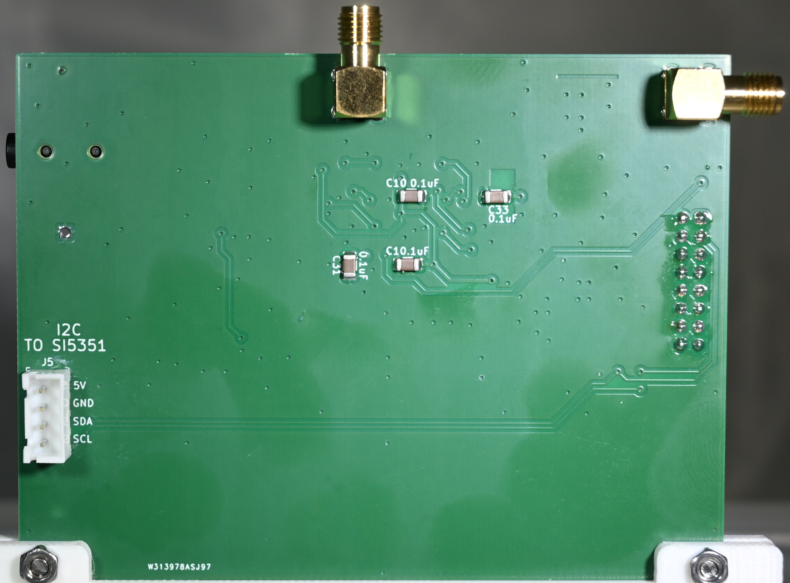

Bottom Side Parts
There are 4 capacitors and 1 resistor on the bottom side. These should be soldered last. I was able to use a hot air gun without any problems with the top-side components desoldering.
SMA Connectors
Take a good look at the placement of the board in your T41 radio. You will want the SMA connectors of the QSD2 in the orientation for easy coaxial cable routing. I used 90 degree connectors as this was the easiest for extensive testing, but not necessarily the best for permanent installation. Also, you may choose to put the SMAs on one side or the other for optimal cable routing.
The SMA connectors in the BOM are 90 degree.
Please note that the cable from the Main board to J1, which is the receive local oscillator, should be as short as possible. A cable is not used with the T41-2 or T41-3 Main Boards, as an Si5351 module is used.

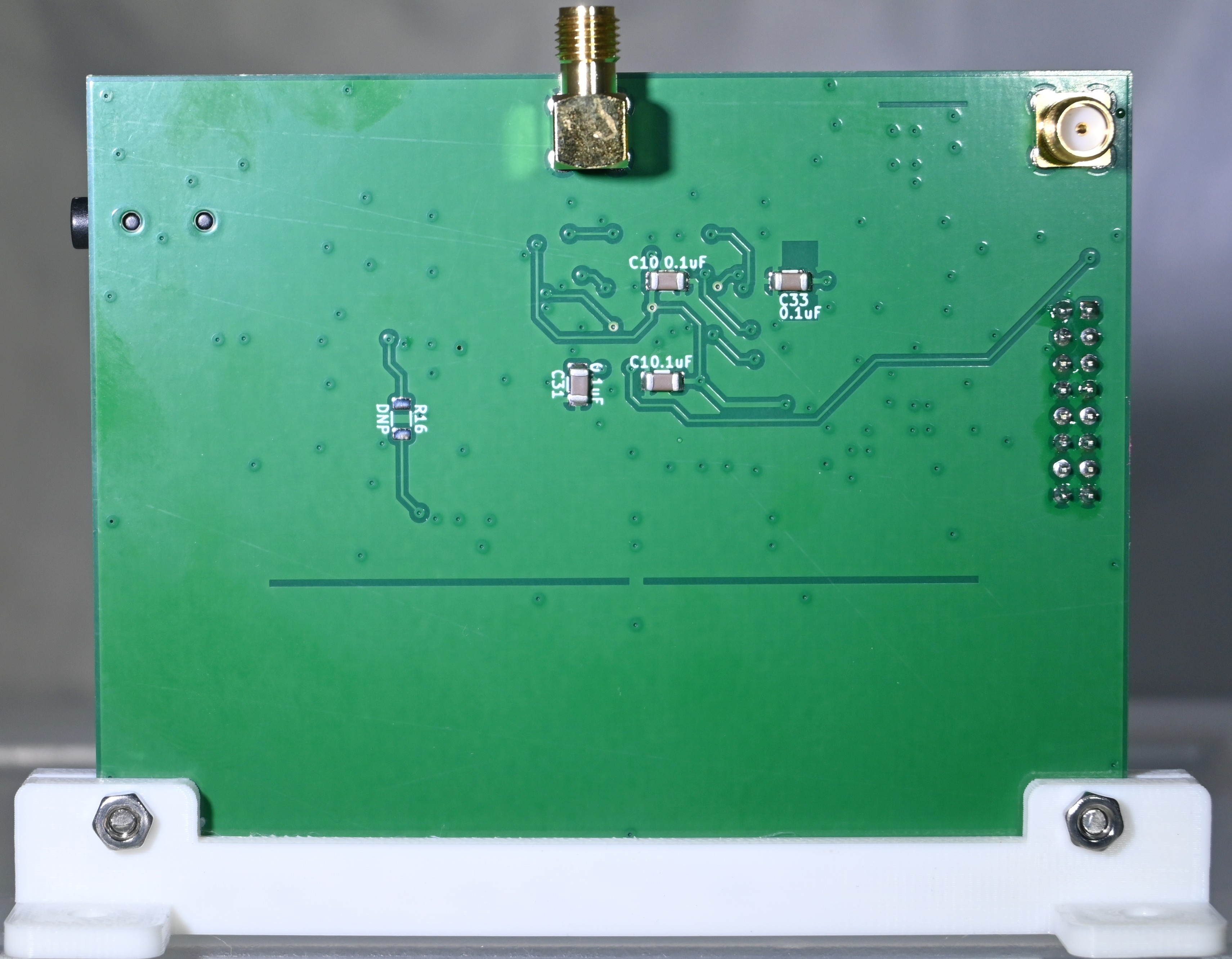

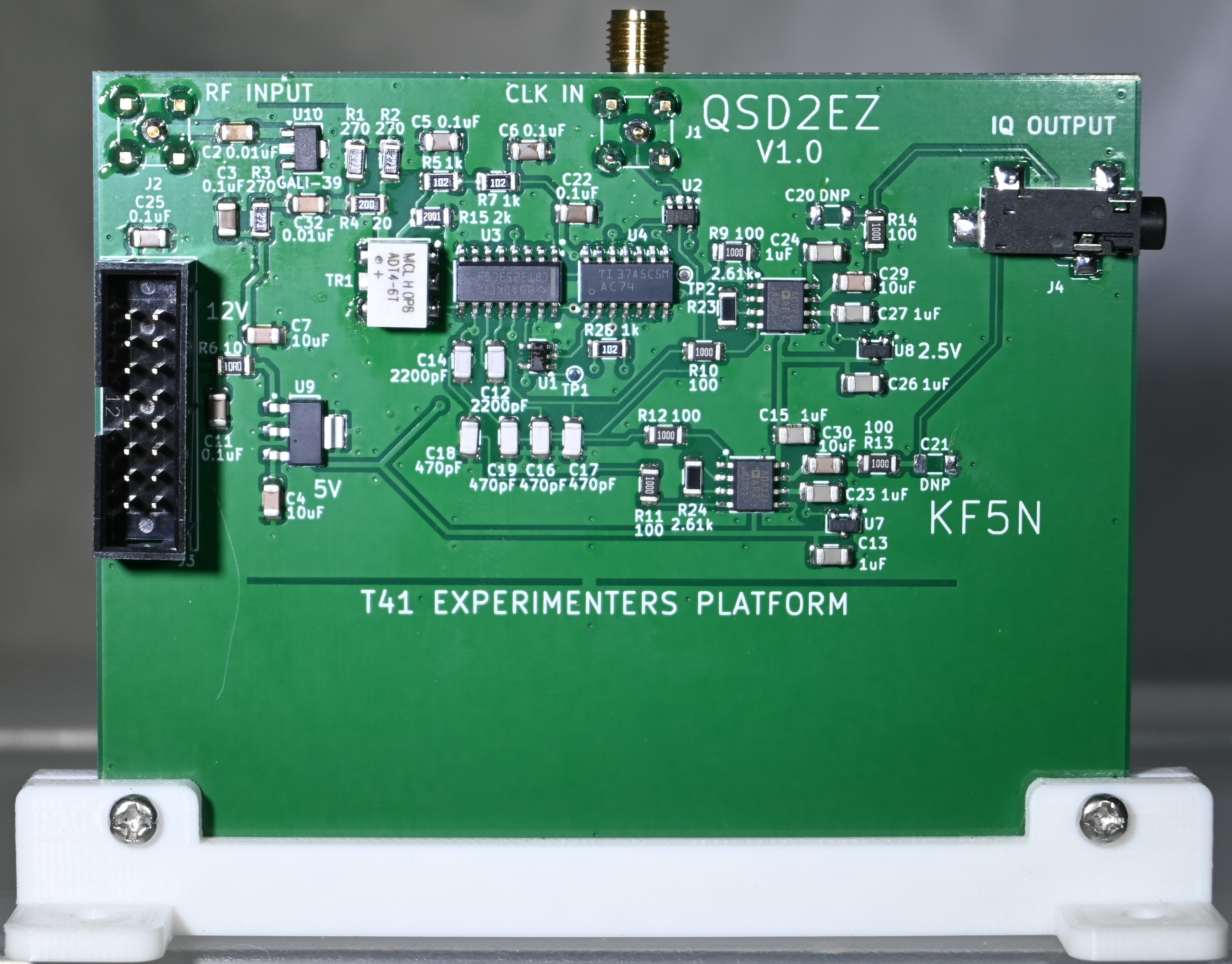

High Resolution Photos of QSD2EZ
Links to photos of a fully constructed QSD2 V1.3 follow. Click the image for a high-resolution image.
QSD2EZ Front View
QSD2EZ Front View
QSD2EZ Back View
QSD2EZ Back View

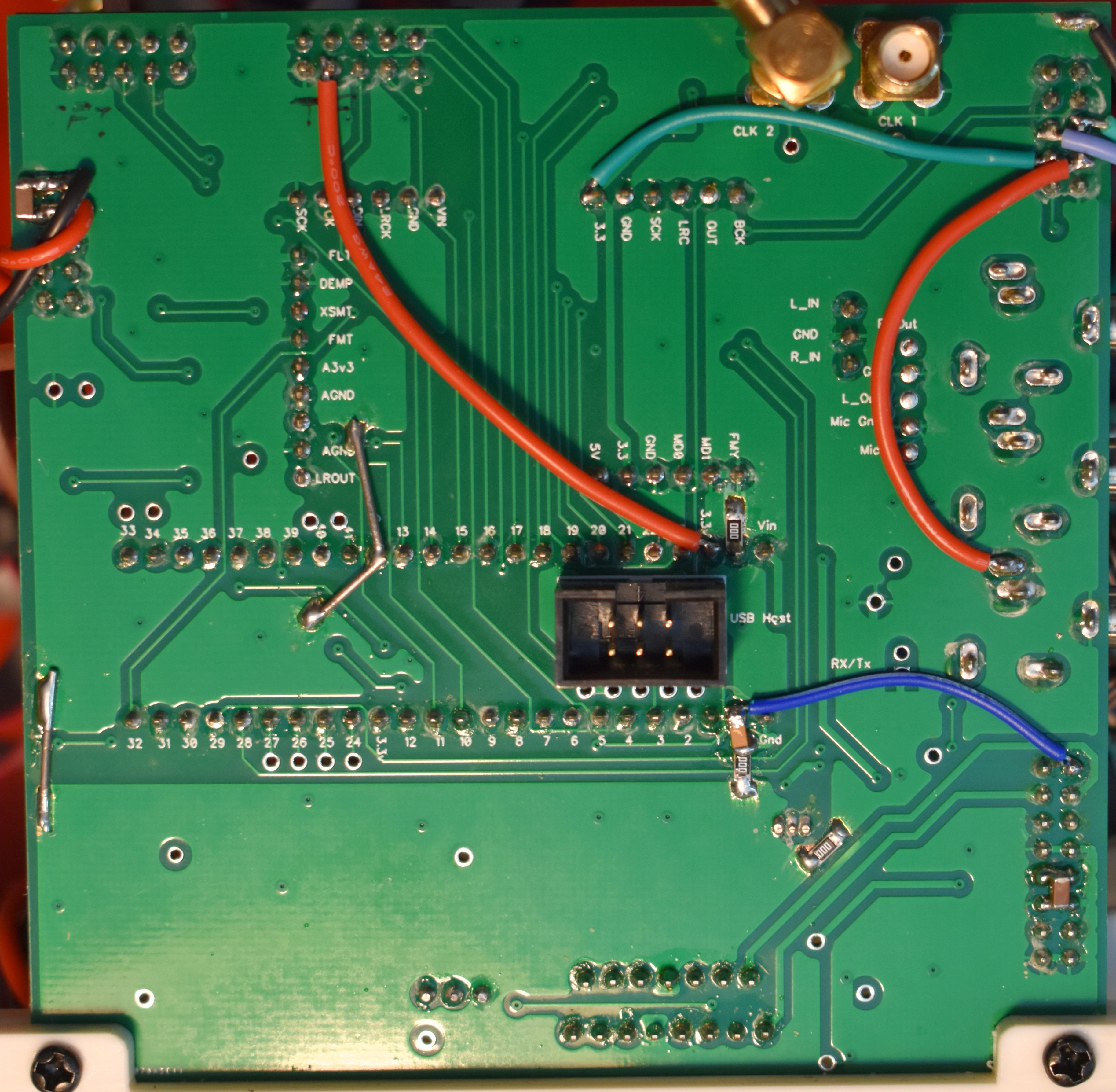

Main Board Wire for Flip-Flop Reset (V10/V11 Only)
A wire needs to be added to the original V10/V11 Main Board (not required for T41-2 Main Board) for resetting the dual flip-flop at power on. The wire is connected to pin 0 of the Teensy. Note that I also added a shunt bypass capacitor to ground. A zero-ohm resistor was required to reach ground. The other end of the wire connects to pin 1 of the 16-pin IDC connector. It might be better to tack the bypass connector to that end of the wire. In any case, be careful while soldering the wire because it is directly connected to the Teensy. Follow good ESD procedures to make sure the Teensy is not damaged. Here is a high resolution image of the Main board. The reset wire is blue.
Main Board (V10/V11) wire for reset
