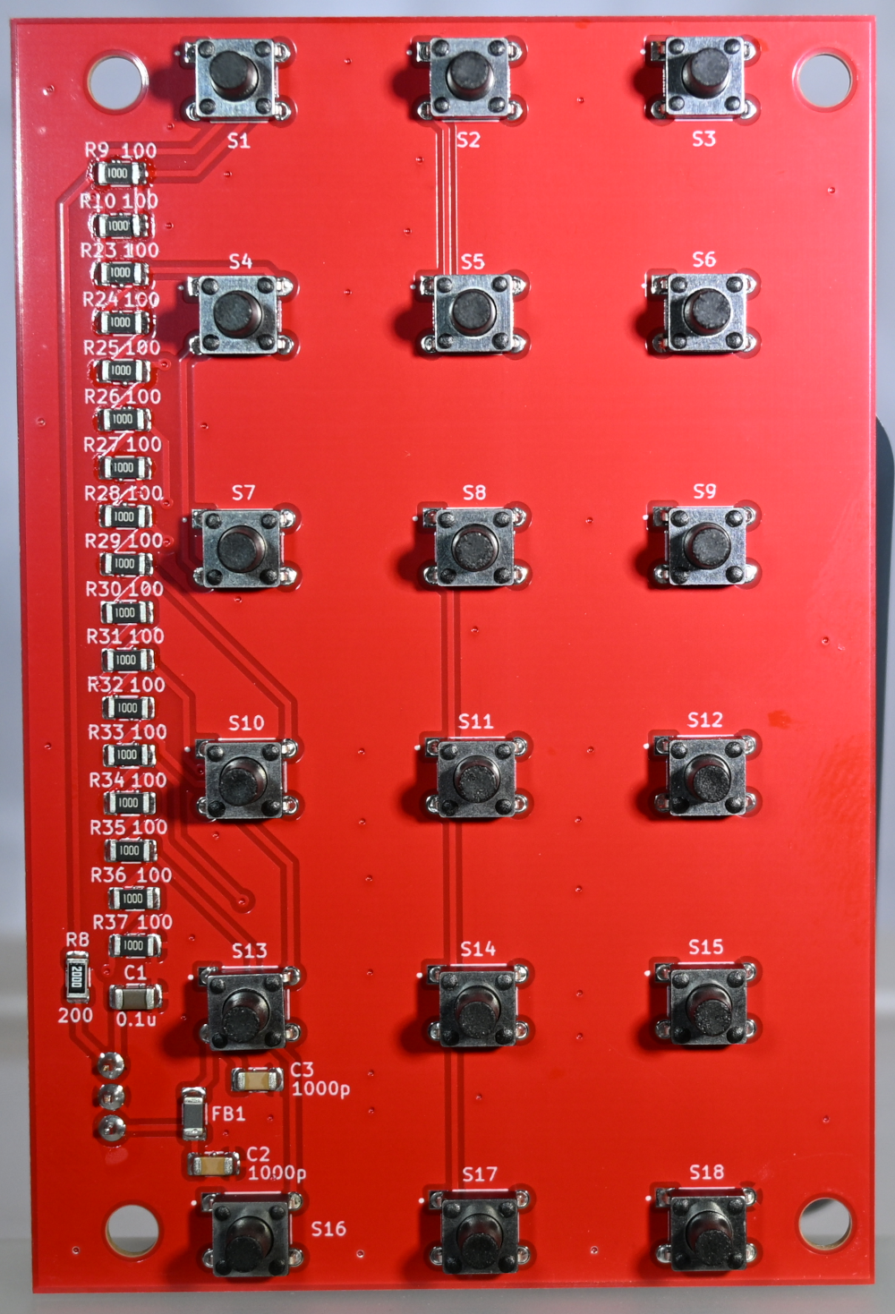

Build Tips
This is an easy board to build. Here are the recommended steps.
  1. Place and solder all surface mount components on the front side of the PCB.
  2. Insert all 18 switches into the front side of the PCB and hand solder them.
  3. Insert the JST connector into the back side of the board in the correct orientation and solder.
That is all!

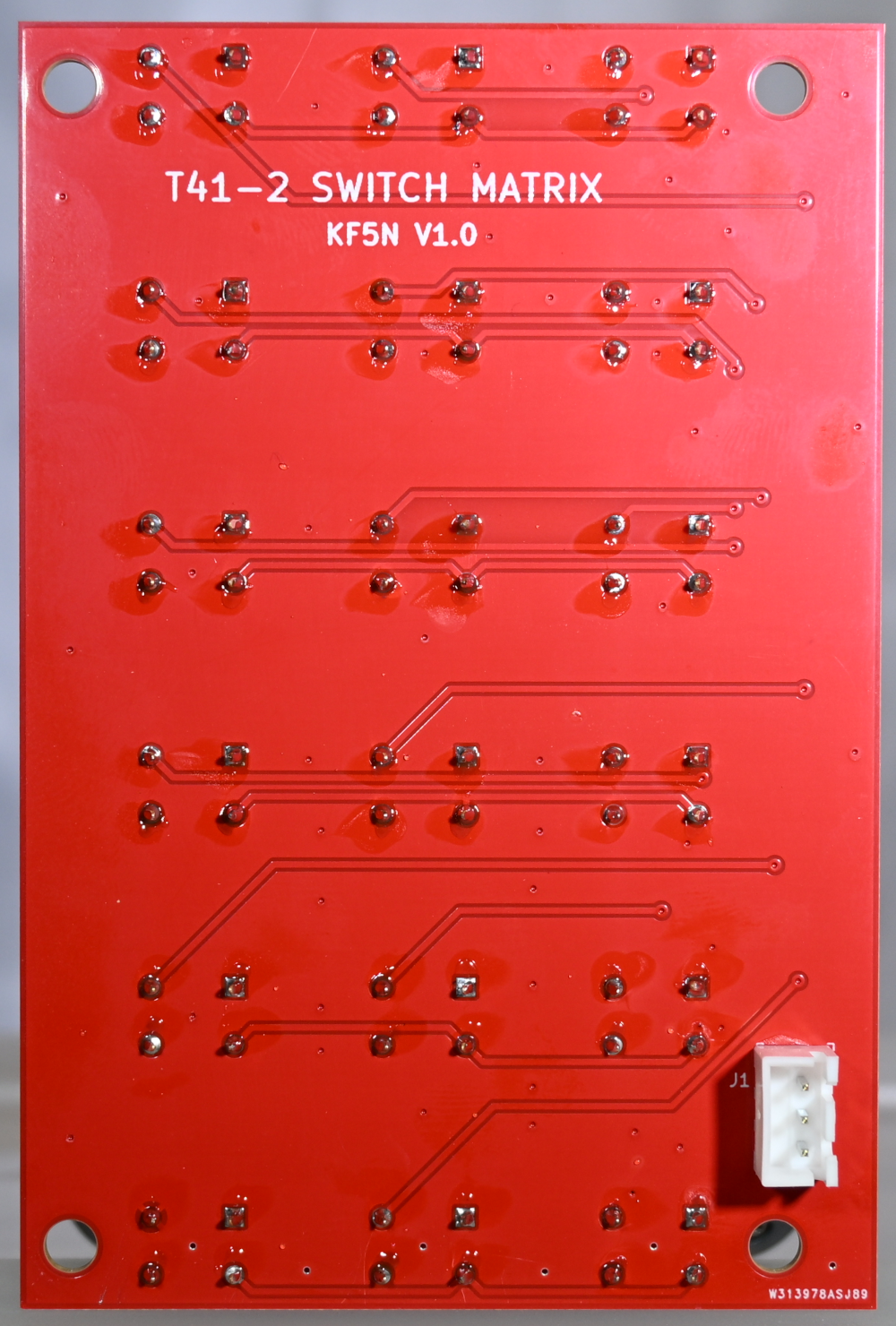

High Resolution Photos
Links to photos of a fully constructed T41-2 Switch Matrix Board follow. Click on the image for high-resolution photos.
Switch Matrix Board Front
Switch Matrix Board Back
